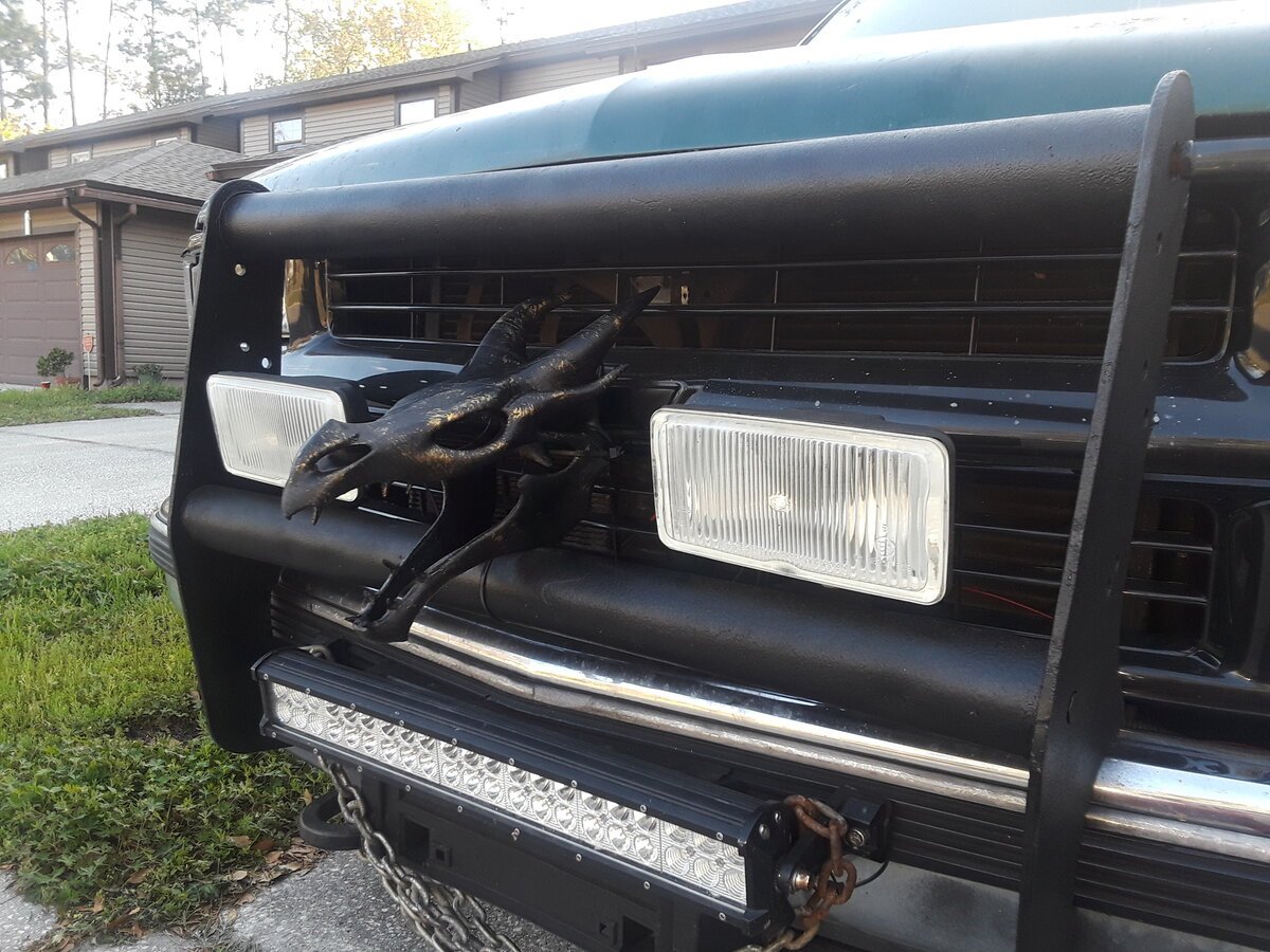

Westin Trailblazer series 42-2005 tube bumper has been ordered.
It will require some fabrication in order to fit this bumper onto a second-generation Ford Explorer. This modification will be done so that the bumper clears the front hitch receiver, which will still serve as the primary recovery point. It is my intention to have a hitch-receiver-mounted winch plate fabricated in the future, which will be designed to clear the bumper. This will allow the winch to be easily removed and reinstalled.
My intention is to add some KC or Hella flood lights to the bar and/or the roof, and mount factory fog lights onto the corners of the bar, pointed diagonally outward slightly so as to improve the field of view. The factory fog lights aren't bad at all, and they are road-legal, which cannot be said for all aftermarket driving lights. Any recommendations for NON-LED driving lights are welcome and wanted. Personally I'm leaning toward rectangular Hella's, as Hella tends to use aluminum housings.
I didn't want to have to get a winch, but it's easier to have a winch than it is to have somebody else to go with you in an other truck every time you want to try some thing dumb. With hitch-receiver-mounted winch plates, if I run power to both the front and rear of the vehicle, I would be able to put the winch on the back if needed. I could also buy a second winch, but for weight and storage management purposes I think one relocatable winch is plenty.
There is a slight concern for overtaxing the electrical system, running all of these lights and the winch at the same time; as I don't intend at this time to configure a dual-battery setup or run a high-output alternator, I am fully expecting to have to turn off any optional auxiliary lights during winching.

I've heard good things about Badlands. I'm not after the fastest winch available; in fact, I sort of think slower would be better, for my purposes. But I'd like to have a hardwired remote if possible, with or without a wireless option.

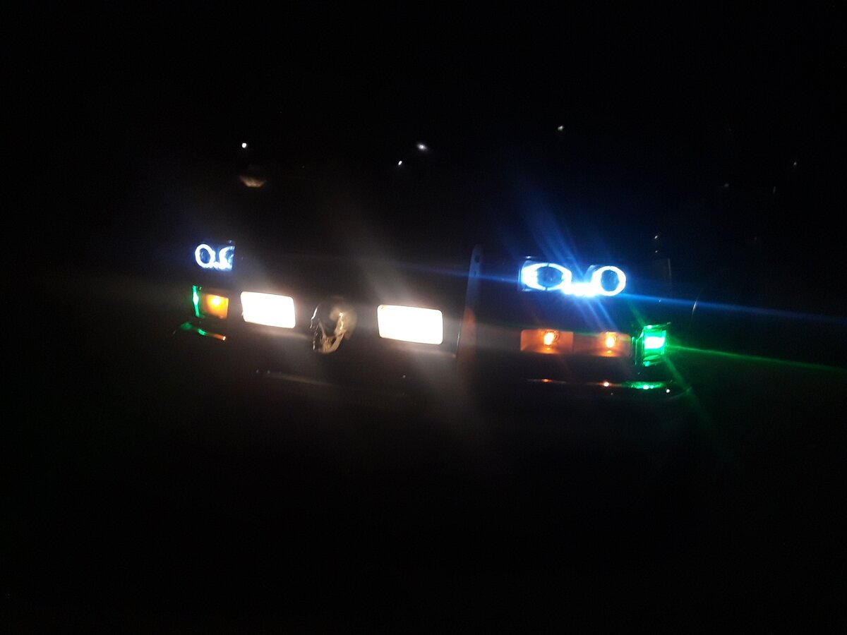

@DemonMudder I don't need forward range, as I rarely go faster than 35 MPH off-road; I need a wide spread. The Internet fails to discuss beam patterns, but judging by shape, I'm going to guess that the Hella 450 is probably among the best picks for my uses, as its dimensions are fairly small at 161mm x 90mm x 60mm, and it can be had with amber or clear lenses. It is one of extremely few options available with stipulations for "driving" and "fog" beam patterns. A pair for the bumper and a pair or two for the roof (fogs at the corners and driving in the middle) ought to be more than enough lighting.

@DemonMudder Hmm, that's somewhere in the scope of about perfect. Thanks for the pic, that helps a lot!
No problem at all! I was so close to going with a few just like those for the roof rack, may do like you and do some sets like those for the explorer since she needs some new lights!

Oooooooh lighting!
Correct me if im wrong but arent those halogens? IMO (and this is literally IMO) the LEDs will do better than Halo in trail conditions. I have Diode Dynamics fogs on the Explorer, very bright very good throw. The Ranger got Auxbeam spot flood combo. But they also have spot or flood non combo. The Diode lights I couldnt be happier with. Aux has been very good too, throws very good light and has a very good pattern for the $$$. I think the Aux was something like 130/pair and the Diode 2something/paiir.
Last I checked Hellas were something like 150/pair or thereabouts, if youre buying say 3 pairs thats 450 in lighting- I think theres better bang for ya buck but JMO! Im happy to snap some pics of the lights and test em
EDIT: I scrolled up forget what I said about LEDs haha! In that case Hella is a good bet.

@Fix4Dirt Not a fan of LED lights, personally. I prefer halogens because they deliver a constant, natural light. It's not as bright as LED's, sure, but it doesn't glare nearly as much, and it's much easier on the eyes. I don't know if other people can see it, but I can see the LED flicker with my naked eye. I know that flickers such as that can (and do) trigger epileptic seizures, and law enforcement uses flickering lights to trigger nervous reactions as a crowd control technique. While I don't have epilepsy, I am a human being and cannot take the risk of having any adverse reaction to unnatural light patterns in a trail recovery situation, as that could result in me becoming a gator snack, and then who would feed my cat?
