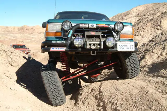

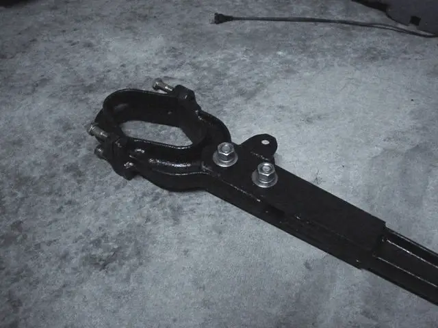

Here is my wristed arm. It definitely helps the flex. I also just leave the pin out all the time.

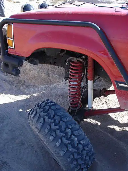

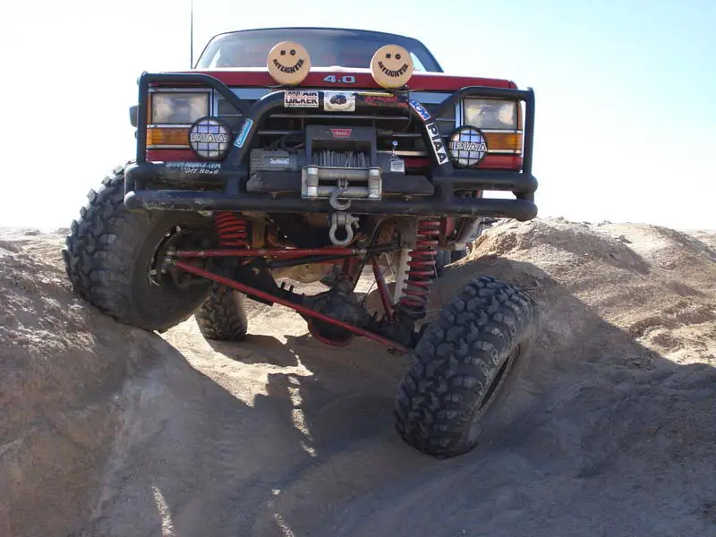

You can see the difference in these pics. Look at the front and rear tires. In the first pic the rear tire is more tucked because the front isn't flexing as much. In the second pic, the front is flexing more so the rear isn't working as hard. This isn't maxed out yet either.
This one is with the pin in:
This is with it out:
This one was close to my max flex.

My radius arms are only extended about 5 inches, but they have also been recently heimed after my RA bushing chewed themselves up. The first two pics are with just the wristed arm and the second two are after the 5" extension and heims. The heims added about 1 to 2 inches of flex.
