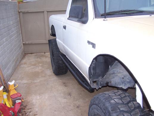

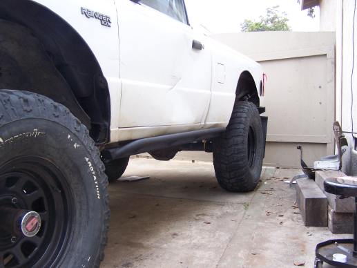

I took the day off of work today :D and decided to work on the truck a bit for the trip to moab. It was time to start playing with DB1's tube bender I picked up from him like a month ago. I decided to start out on my sliders cause I only had about 18ft of tubing at the house. I added a 1.5" 120wall dom piece to my sliders to hopefully help keep the damage away from the body a bit more. It was my first time using a bender to make anything so it took awhile to figure it out. I need a better way to cut steel other then a cutoff wheel on my grinder. Those $500 plasmas on pirates are looking pretty tempting. I also over the weekend added limit straps to the front end cause the shock were starting to pull away from the frame. I didnt take any pictures of the limit straps.

Looks good Matt :thumbsup: You should just go over to HF and get you a cut off saw for $50 bucks ;) You can't cut anthing on the truck but it's perfect for tube, and box
is
I had a HF chopsaw before and I was never happy with it. I could never get it to cut square. The blade would always wonder on me. I tried different blades light pressure hard pressure but could never get it to work. I have an old band saw right now but the blade is dull and it is to big to be easy to use in the area I have. I am thinking plasma right now. Need to see how much this trip to moab ends up costing me.
