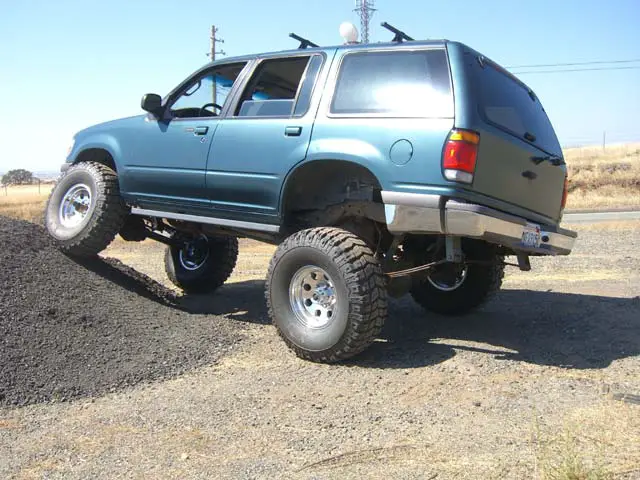

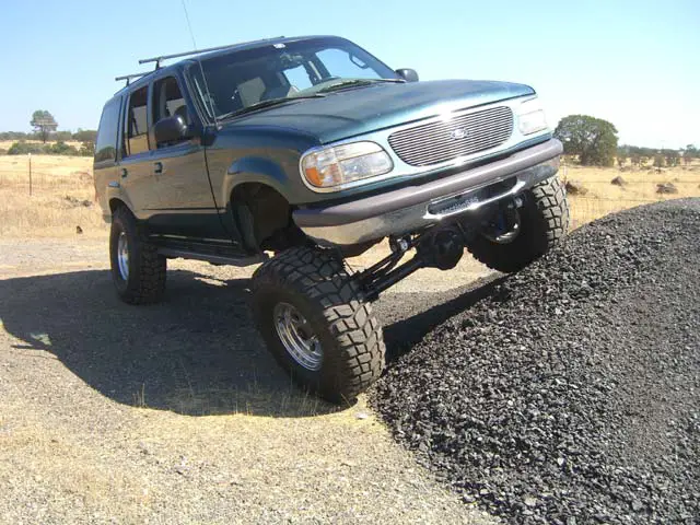

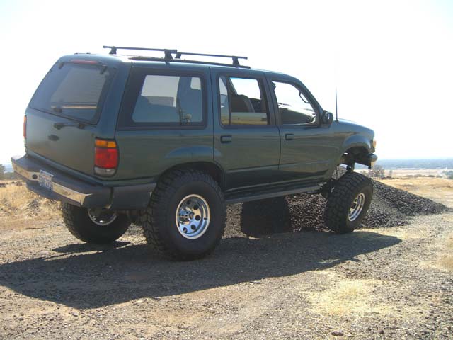

Well I know everyone was tired of the driveway pics so I went to put some fuel in it and decided to take the digicam and find some dirt. :D
This is all I can offer as of now. :( I really need to disconnect the shocks and run it down to Bent and Twisted to I can measure for new ones. These Tom Davis specials are just sort of mock-ups. :p Other than that.. once I get some 4wd and lockers.. it should go better.

how does it ride? Flex looks good!
It rides pretty good. I take it on the highway now. So that's a plus. :p
I sorta get this body sway deal going on occasionally. So.. I don't know what the deal is. When I pull the axle out to get it rebuilt I am probably going to re-do my shackle hangers. They are not 100% parallel with the leafs. So if the spings compress.. the leafs sorta go away from each other (in theory anyways). So I dont know if that has something to do with it or not. Plus the driver's side is noticably lower. Meaning A) the JCW springs sucks, or B) the perches aren't quite happy together. Once again, I'll check that, and swap the leafs to opposite sides, when the axle comes out.
