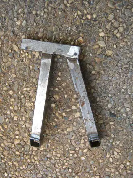

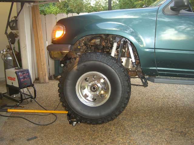

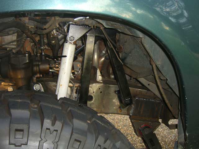

Although it was 103 degrees out (F), I actually did something. My reamer came in the mail yesterday, so I figure after I ream out the pitman arm and driver's side steering arm, and get some shocks on, it will be streetable again.
So, here's the driver's side shock hoop so far. :cool: Tomorrow both should be done and it will be on the roooooad.

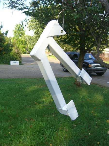

Paint booth!

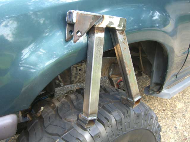

all that just to not run f250 towers or did i miss something here....but those are bad ass, different but bad ass
Don't those go above a frat house door or something?
F250 towers would push the shock out towards the tire further. Plus they're designed to be bolted on, meaning I would have to weld the piss out of the rounded gaps. This way I can just grind them off if I want to change something down the road. Plus, they're custom. :cool: :p
I ended up not having to leave town tonight.. so I got everything reamed out. :cool: Rides a little better with one shock on. Hopefully after the second one goes on tomorrow it will ride like a Caddy.
