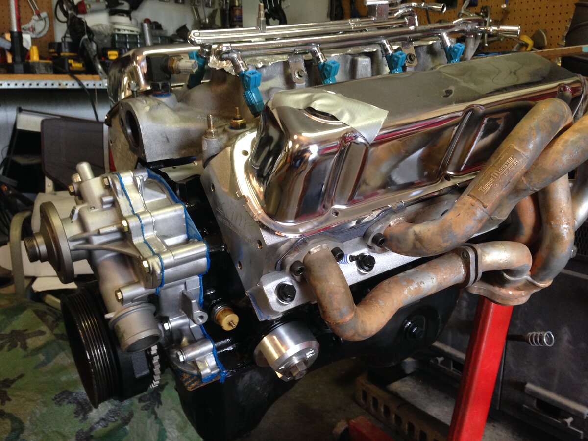

its a longblock (engine and heads)
Add the explorer timing cover, oil pan, accessories, headers, intakes and BLAMO crate engine
We used a 97 Explorer computer, intakes, fuel injection, etc
I am not sure we hit the 365 hp mark with the stock computer and injection but in a 84 ranger it is PLENTY of power
It is a worked over 302 with aluminum heads
ATK is one of the best in the industry last time I checked they make THOUSANDS of engines so no "Crap shoot" that components will work together like you can get going to local machine shop
Darth Ranger has been running this engine for about 10 years now not one single issue
those are the "prototype" TMH from my BII that were used for building his first set of TTB truck "conversion" headers

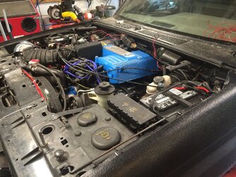

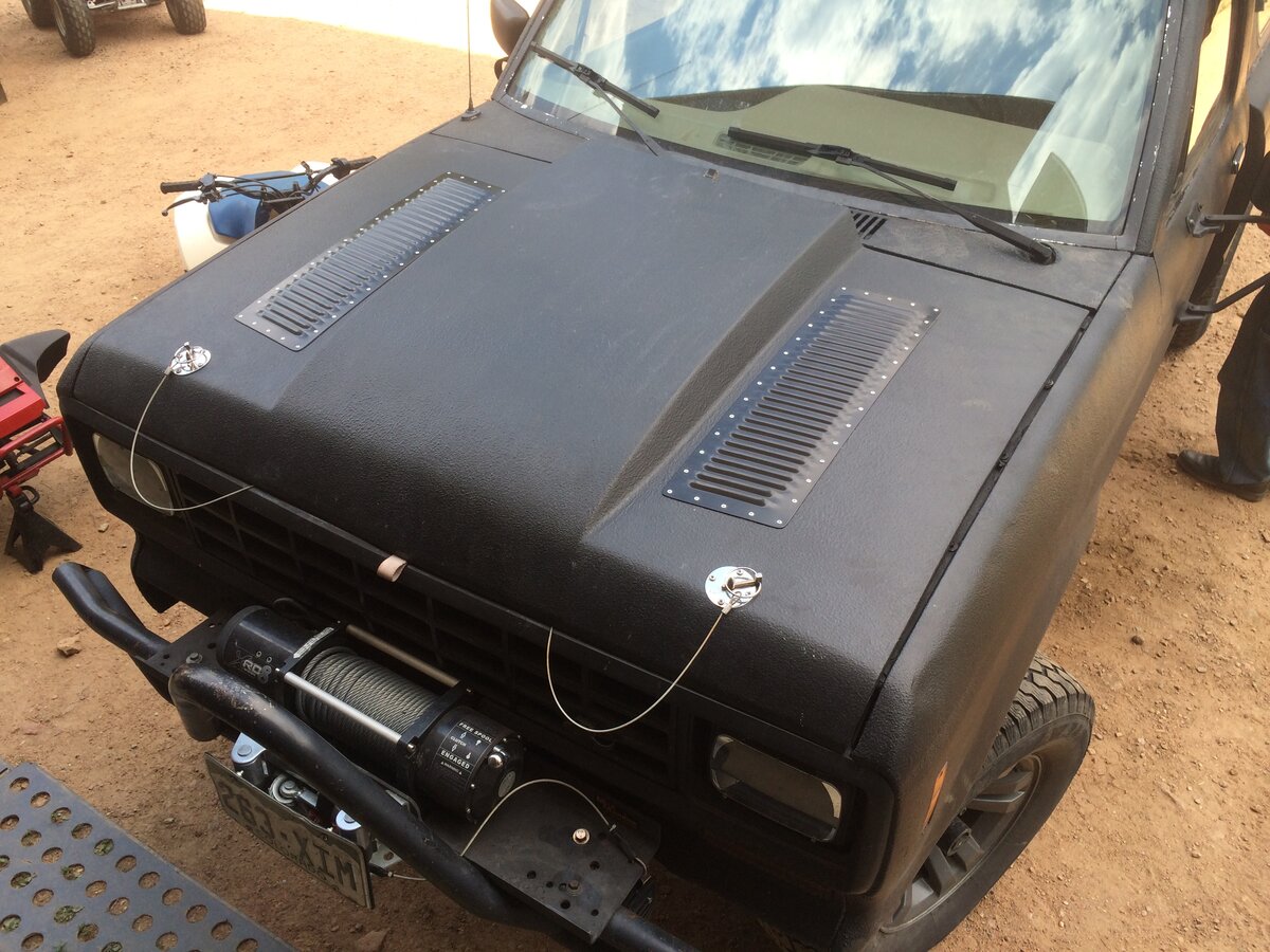

dual batteries ac and cruise control, radiator tuck, all under the hood of an 84, no body lift.
And they say it cant be done
truck is custom bumper to bumper we built it for him to go "fishing" lol
