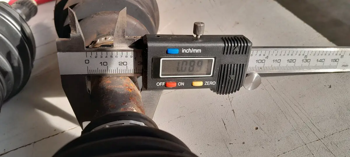

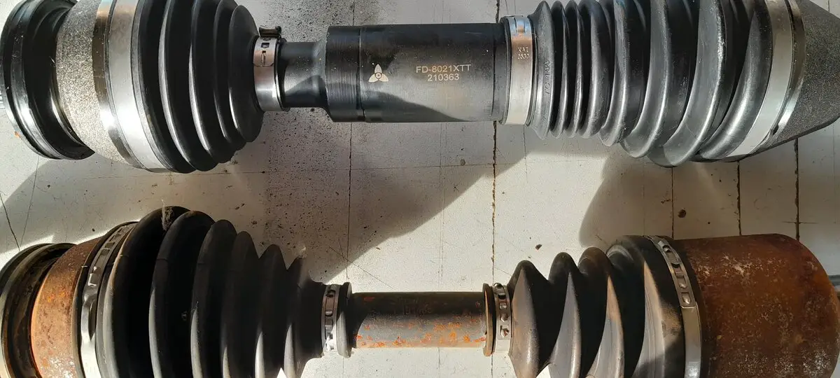

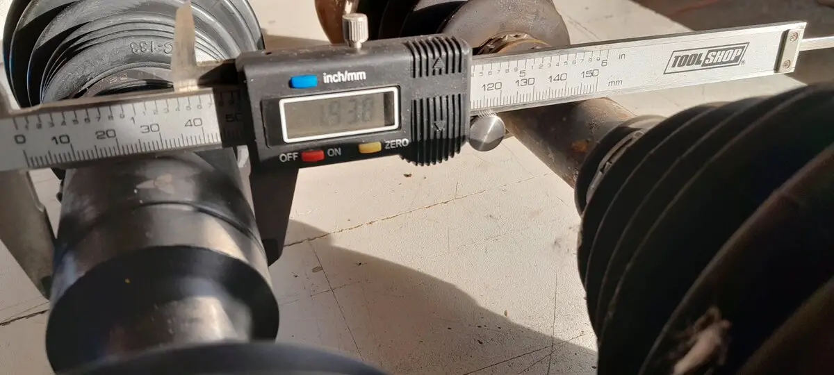

Started to swap the CV's out last weekend, but wasn't paying attention while on the stupid cell phone, and stripped out a caliper bracket bolt. Derp...
Spent the rest of the weekend searching for my tool bag full of all my extraction sockets..... Nope, the bag grew legs and walked off.
Went to 4 places before I found a set over the week. Seems these are extremely rare around me. (wtf)
Today, I got the bad bolt off. it's a 10.9 metric, 12x1.75, shoulder bolt with a head flange that gets 150 #'s thrown at it.
Went to 6 places to find a new bolt. Nope, these are even more rare. No luck. Found an all thread grade 5, no flange.
Plan is to to use it just until I find the right one, so the rig could be put back together.
Pulled out the 1.5 yr old perfectly fine CV from the drivers side, with the help of a prybar.
Put the new Extension to the old stocker for reference, and did some checking. Turns out they deffo have diff flex angles to them.
The inner shafts: Stock has 20* max. Extension has 27* max.
The outer shafts: Stock has 45* max. Extension has 23* max.
OK, that's odd, as I expected the Extension CV to have far greater angles then the stock, as advertised. Hmmm....
The middle shaft diameter: Stock is 1.089". Extension is 1.938". Almost twice as thick, as expected from the diagram sent to me, from the manufacturer.
They are different then the stockers for sure.
I measured the splines length on both of these drivers side CV's, and they match.
Ok, time to put the new one in, and see if the middle will clear my coil springs or not. Well, I soon discovered I have lost more strength then I realized at this point. Seems a few months of recuperating from a few heart surgeries, and not being active zapped most of it from me. I could not get the inner Clip on the spline shaft to compress and let the CV fully seat in the carrier. I fought it forever it felt like, before I gave up trying. Going to rest up, and try again tomorrow. I will update what happens, after I have more to report.
