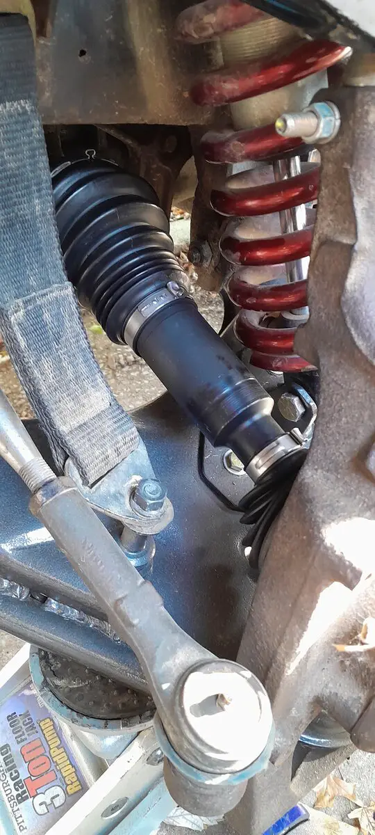

Full view...

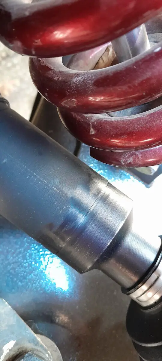

Closer view of the 3/16" gap at the lowest coil winding, at about 3/4 droop... Yes, it's Tight!

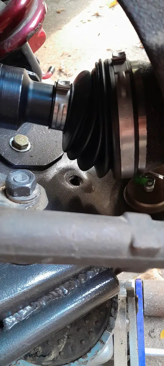

So the part that is not so nice is these outer boots. They rub against themselves when drooped, and they are loud! Like a gorilla wrestling a big inner tube loud. That worries me. I am going to try some M-77 lube suggested to me, and see if it helps or not. Cant wash off, and shouldn't allow particles to stick to it..... we shall see.

Thoughts: This is for my setup, and if you run shorter coils and shocks, with the 2" lower shock extension, This would most likely not be an issue at all. I am worried that the outer boots will rub thru, and cause a roadside repair, and at the least desired location. There is still concern that upon compression, the center shaft will hit the coils. I have only read one review on how these are working on the trails so far. It was positive, but only one.

Those boots will hold up if they are made of good rubber....... time will tell
Wifes FJ cruiser the aftermarket CV's had inner boot rubs on itself like that, one set lasted 6 months then ripped boots all apart, next set (diff brand) still going
