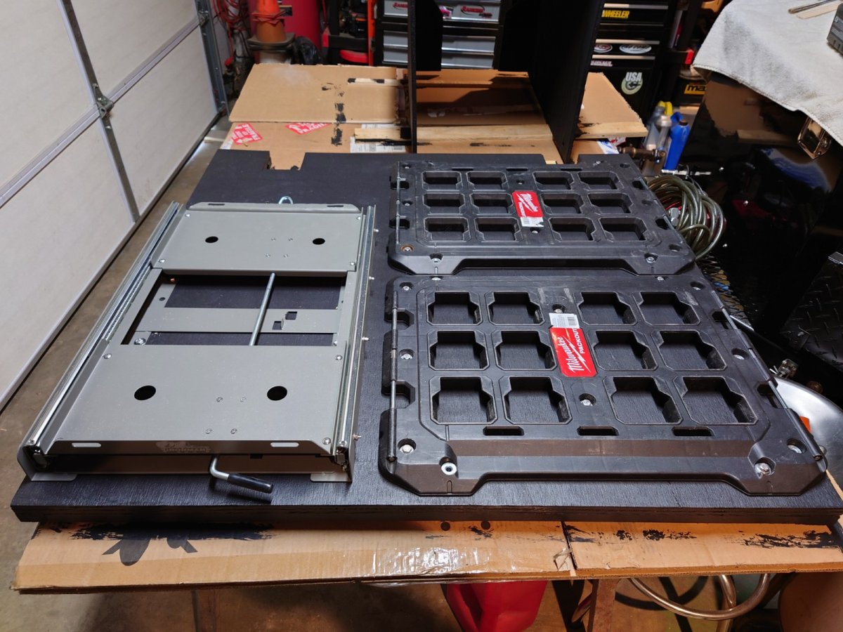

I wanted the rear space to carry what I needed, but only to base camp. Once there, I wanted to remove everything, and only carry what I needed on the trails for minor repairs.
So my idea was born, and I went to work on it. I still wanted to use the smaller fridge so I could be Ice free. I needed to be able to carry tools, parts, and camp gear.

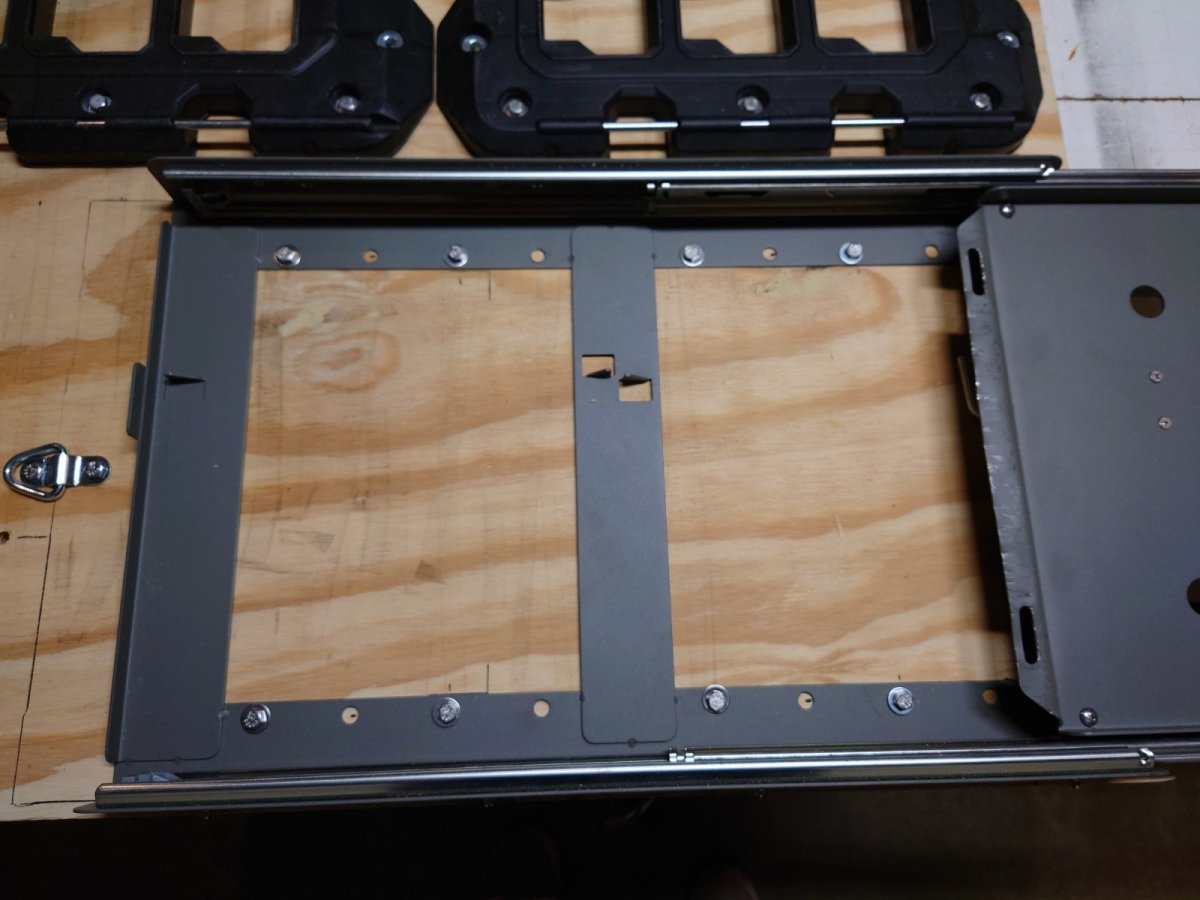

I found a fridge slide from Ironman 4x4, but it was like 1/2" too short inside the tray. I had to modify it. The green arrow shows the direction the lip needed to be bent. I took it apart, and put it in the vise. An 18" crescent wrench bent the lip horizontal, and allowed the fridge to fit.
The blue arrow shows the release latch for the slide, and it had to be clear of the rear hatch door, so it was installed offset on the new base. What base you ask? I made one from 3/4" ply, and braced it underneath. The idea is from the flat roof platforms used, and everything gets secured to it. Same principle, diff materials.

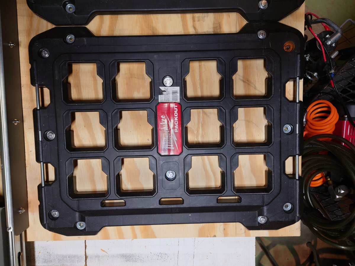

To secure all the other belongings, I chose to use my packouts. I reused the bases from the other box, and bolted everything on with Tee Nuts.

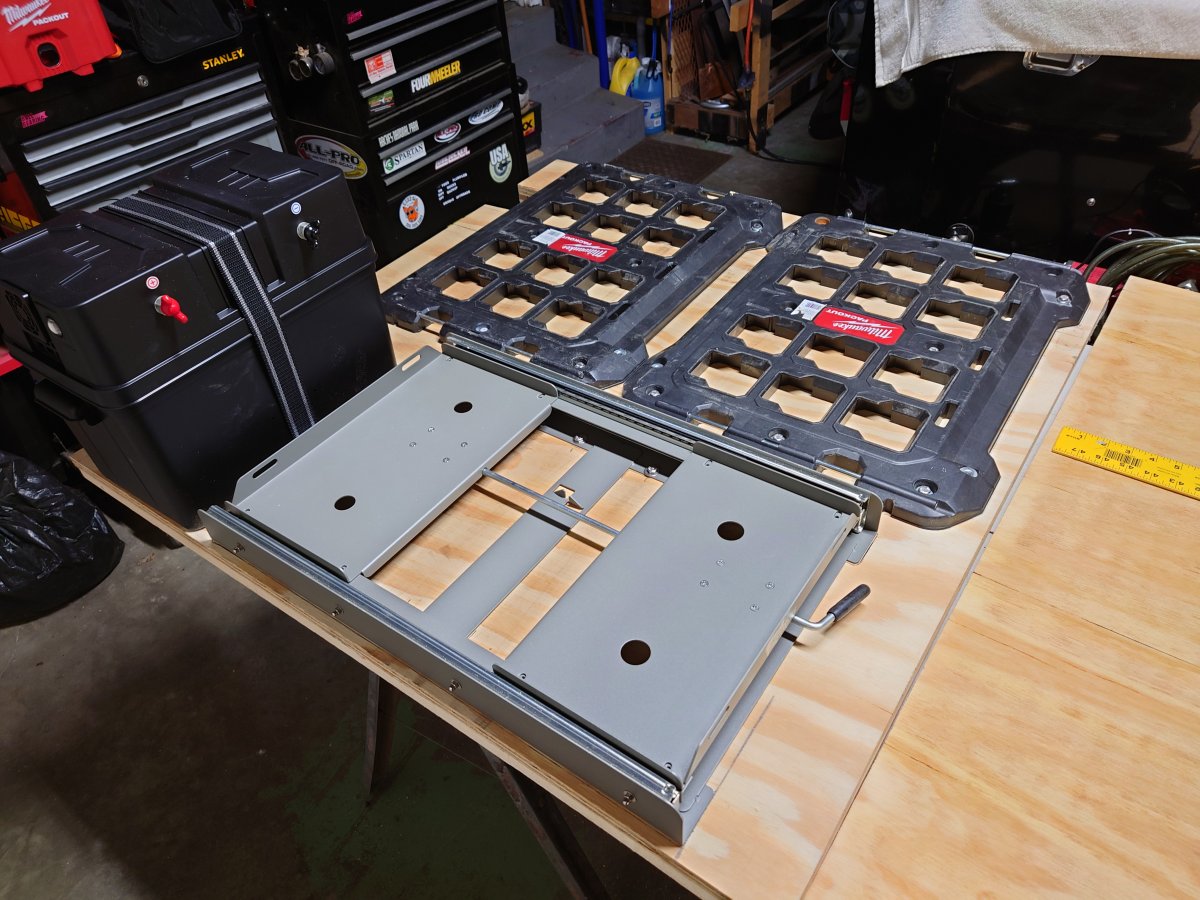

I then decided to add a battery box and I had a couple of nice LifPo4 medical batteries handy, so I got the Ironman 4x4 box for them. Neat little box with 2 fans, 2 -12v outlets, 2 5v USB, a pair of 50amp Hot Anderson connectors, a led volt meter, and a bright LED light.

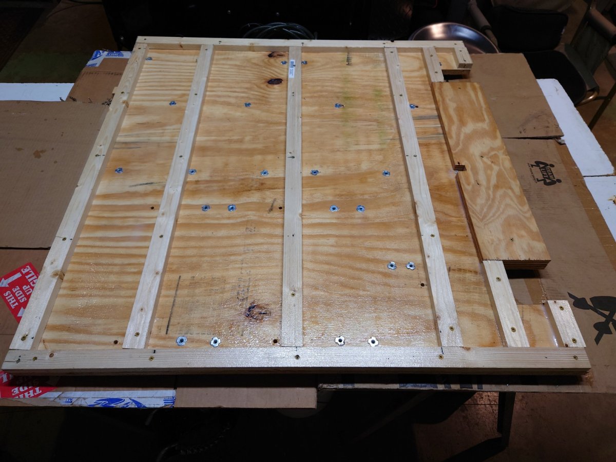

Backside all braced up, and 2 coats of satin clear coat to seal it up.

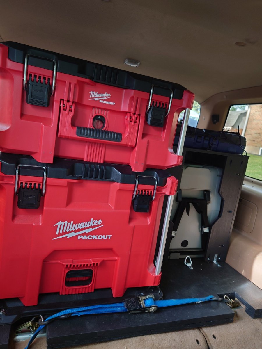

Installed and held in with HD straps the same as the other box in front, but used the already installed E-Track for the backside. Installed some hoops to use for straps to hold a mechanic tool box above the fridge, and added the packouts.
