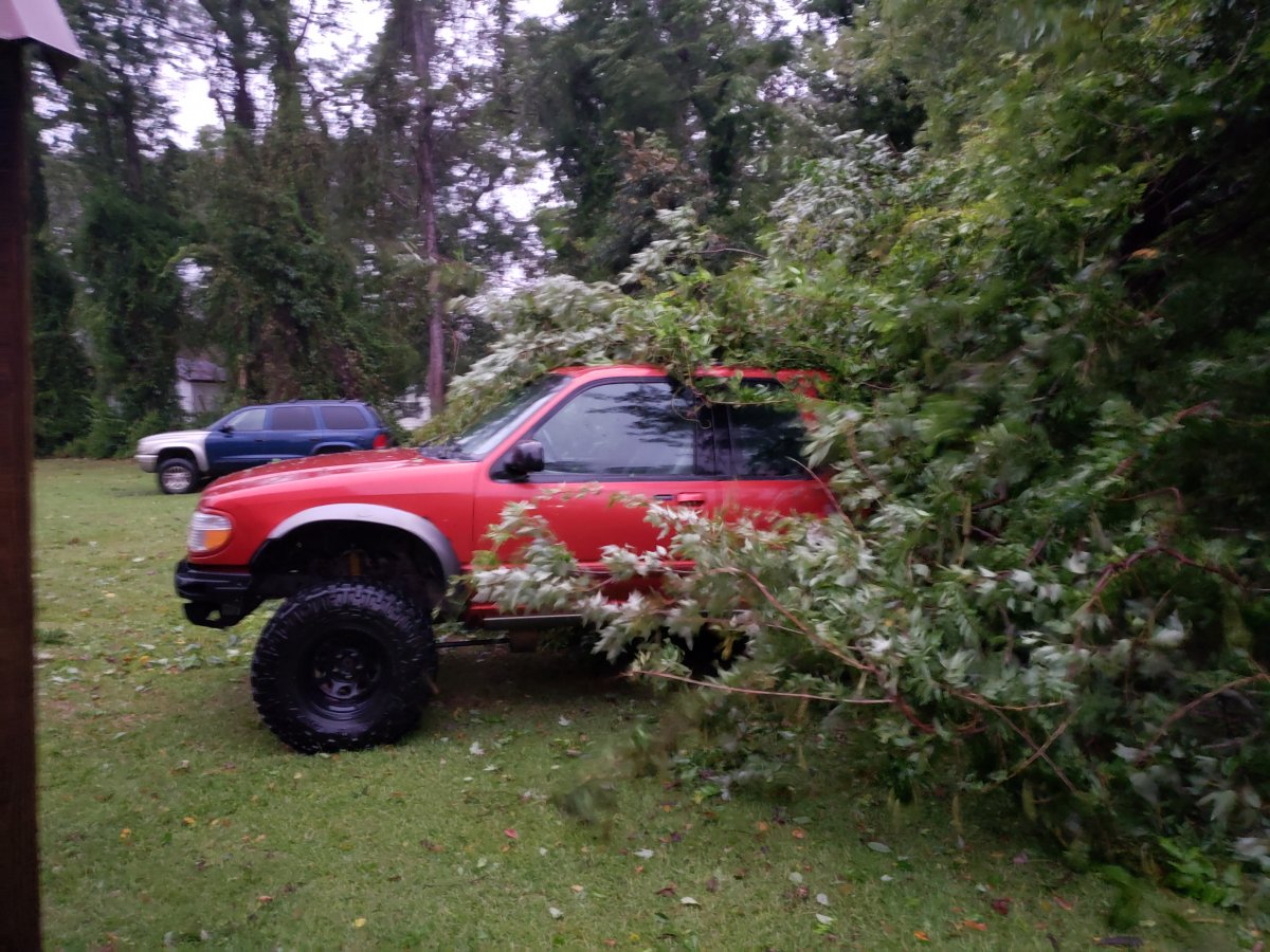

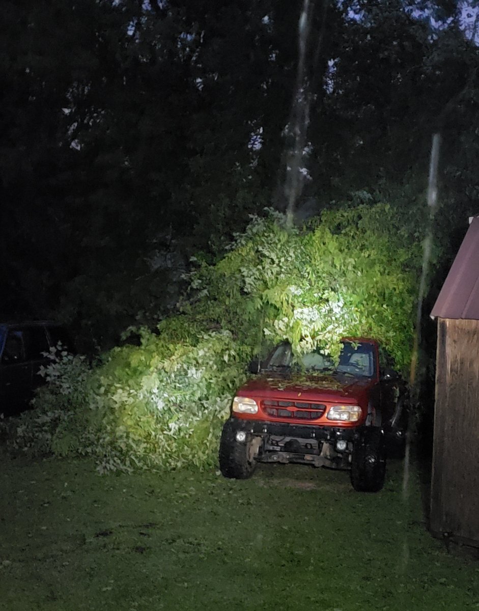

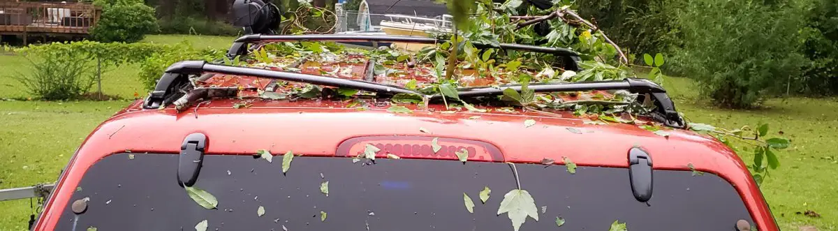

Went out this morning to find this:
Tropical storm Ophelia has left her mark... weak! I count myself blessed for having lost nothing but a roof bar. Could have been a lot worse. There's a dent above the left quarter panel window that I don't remember, but who's keeping score?
Ended up driving her over 100 miles today due to events related to the storm, and sheesh, she is a thirsty beast. 5.13's and highways don't mix.
I wonder if the tree had the slightest idea what was going to happen to it when I got home.
