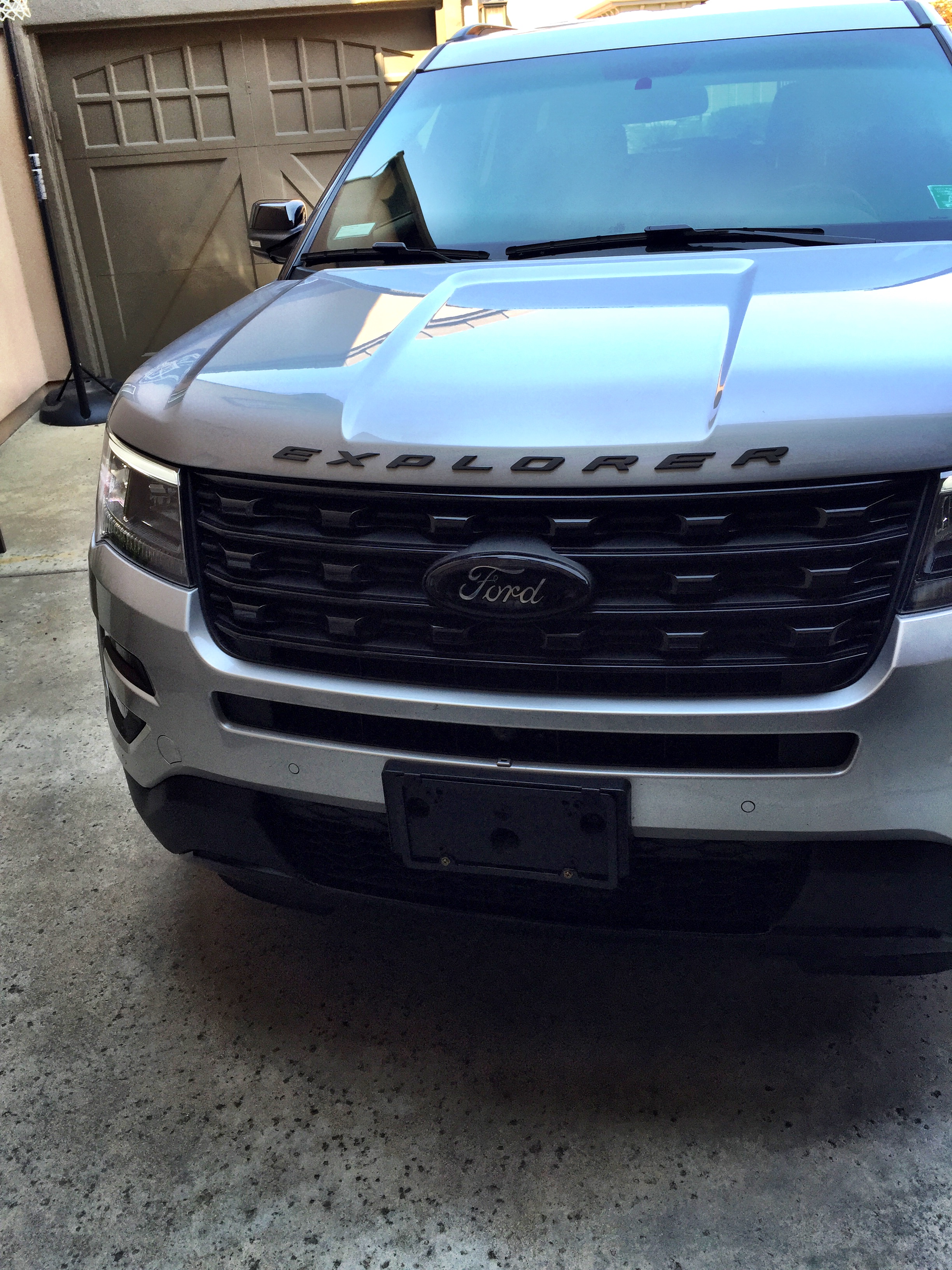

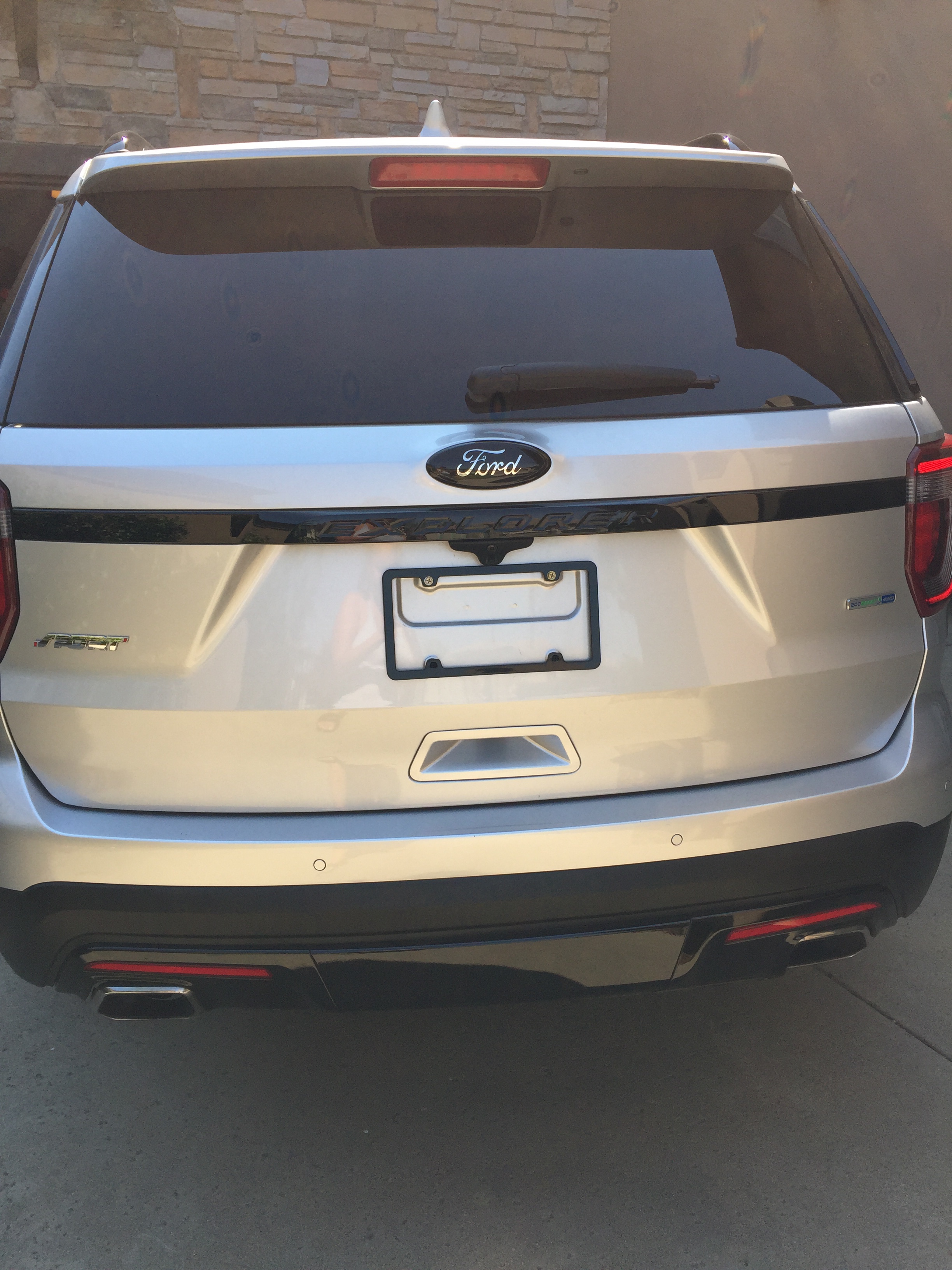

We just finished changing the front and back Ford emblems on our 2016 Sport. We didn't like the blue Ford emblems and wanted black emblems that would look better in the black grill. We bought black, real emblems on eBay, not pop over type or gel overlays. Because we had a hard time finding info on how to do this specifically on a 2016 model, I thought I would just share what we discovered and what made this easy for us.
Back emblem: took about 15 minutes to complete. We used a flat rounded letter opener to get under the edge of the emblem . Then we just kept moving it (could hear the tape lifting) and with a little force just popped it right off. Once off, we rolled the adhesive left on the car with our fingertips to get it off the car, then cleaned the area with rubbing alcohol and put on the new emblem.
Front emblem: took 30 minutes. We DID NOT take the whole grill off. The key here is having two people. We took the cover off the top of the grill which is held on with about six removable bolts/nuts and two push pins that snap out. Here is the big tip...once the top was removed, I pulled the top of the grill toward me with enough force to give my partner extra room to get his hand down in there to remove the two screws holding the front emblem. He was able to get his hand down there with a 10mm socket (about 1.5" long) and get the screws off and the emblem came right off. We then cleaned it again with alcohol and put the new emblem on. Without the second person holding the grill out, it would be very difficult to get your hand in and remove the screws. So you either need a second person or you'll probably need to take the whole grill off.
It looks so much better with the black emblem !!
Show some pics of the new ones installed.

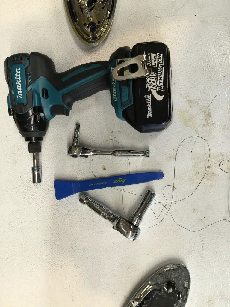

Did my 16 today. I had to use a deep well 10mm to get the nuts of the front emblem. Did front and rear in under 1/2 hour.
Here are all the tools I used front and rear.
Fishing line to get under the adhesive on the rear emblem

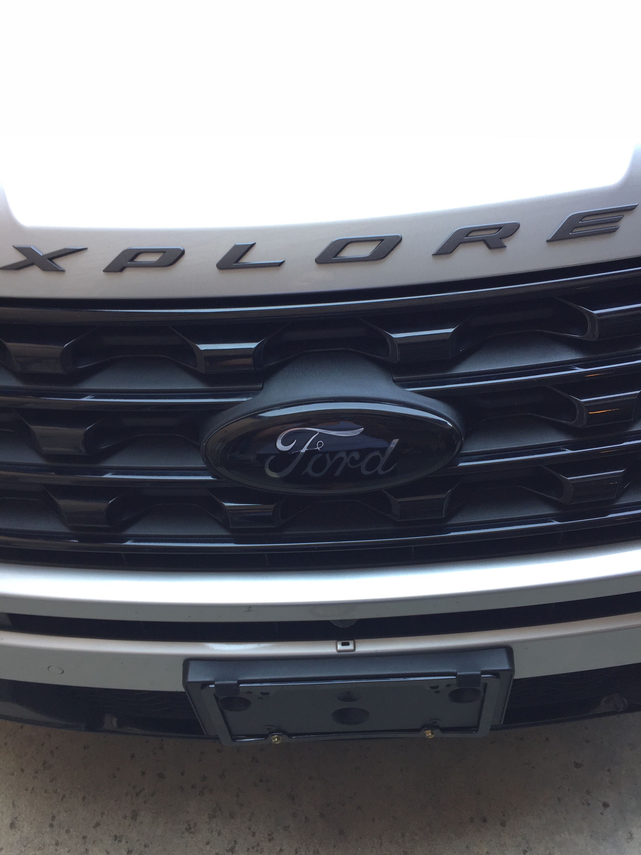

Does anyone have pics of these new emblems in a matte black finish on a Sport?
