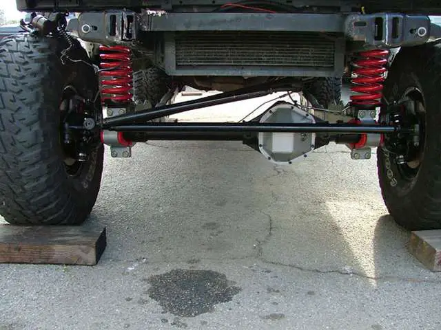

And..........this is not your daily driver anymore, its officially become a TOY! Congratulations, it looks great Stic. I did notice in the pictures that you had a wood block keeping it from rolling down the driveway........does this mean its not drivable yet? Come on, lets go wheelin!!!!!!!! :p
Unfortunatly, it will have to be a DD for a little while longer. say another 6 mo. or so. Until I can pay some stuff off, including the truck :rolleyes: Then I'm going to find my a mid 90's F-250 tow rig/DD :D
No it's not drivable yet. I'm picking up the brake lines tommorow. other then that, I just have to put the shocks on and figure out if my d-shaft will work. my new T-case is coming next week, so I'll have to through that in too. ;)

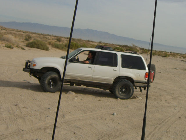

Remember how small it use to be? :o
I was taking a picture of Colin's antennas (the one I later stole) and your truck got in the way. :mad:
You have no idea! :D
and a picture from my second run....ahh I remember like it was yesterday, and I remember Bkenndy say'n "I had balls!" LOL :p
I actually have video of me on this run, as well as Colin's trucks before it was his in Big Bear :D
