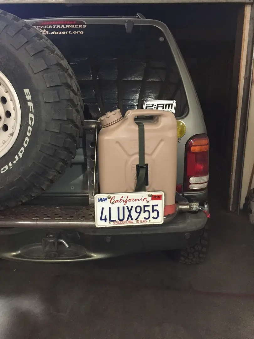

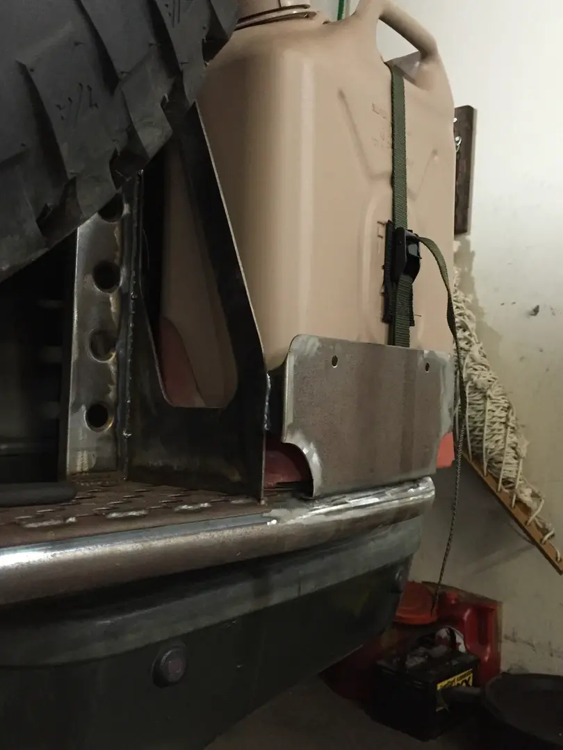

Not much of an update, but finally made the license plate mount. Ordered a pair of these custom straps from Strapworks, affordable and look like pretty good quality.

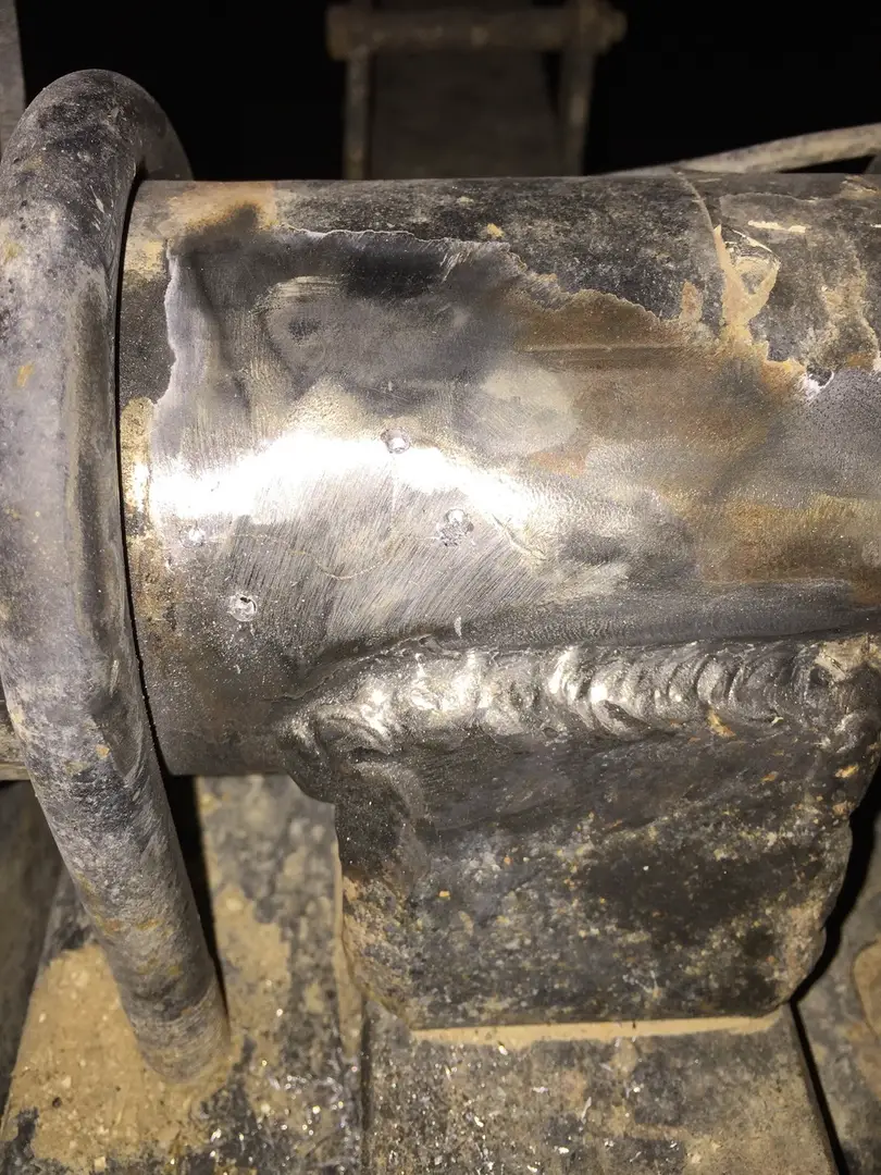

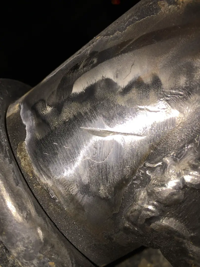

Apparently 1/4" thick axle tubes are still not thick enough. I noticed a few months ago that I had gear oil leaking out of my axle above the leaf perch in between the u-bolts, and I had this big gouge in the axle tube from when I cut off the stock Bronco perches to install this axle last year, so I thought that's where it was leaking from. I finally decided to fix it last night and I realized that's not where the leak was. You can see the really fine crack below the gouge.
The crack was a lot bigger than I expected. To fix it I drilled holes at the ends (4 because the crack split into an X shape), plug welded the holes, ground it flush, then plated over it with an 1/8" thick square with a hole in the center. I welded it really hot so hopefully that will keep it from spreading any more.

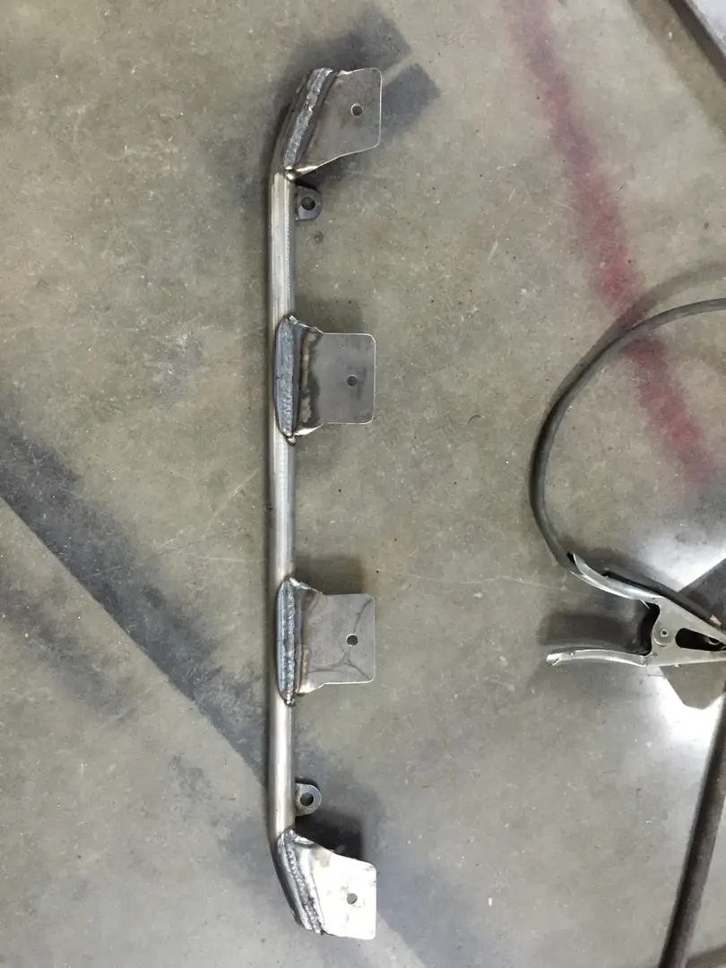

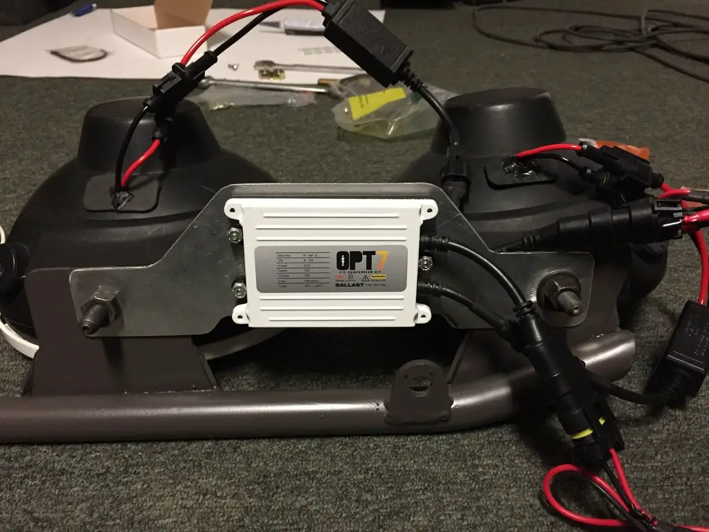

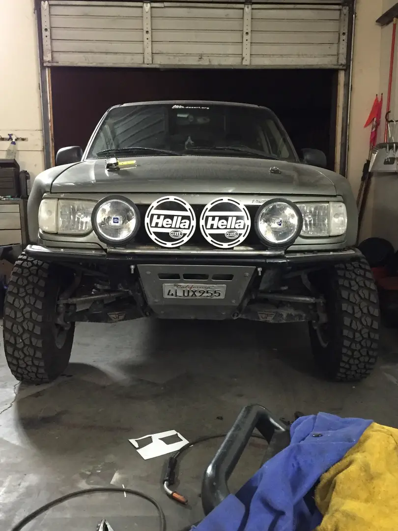

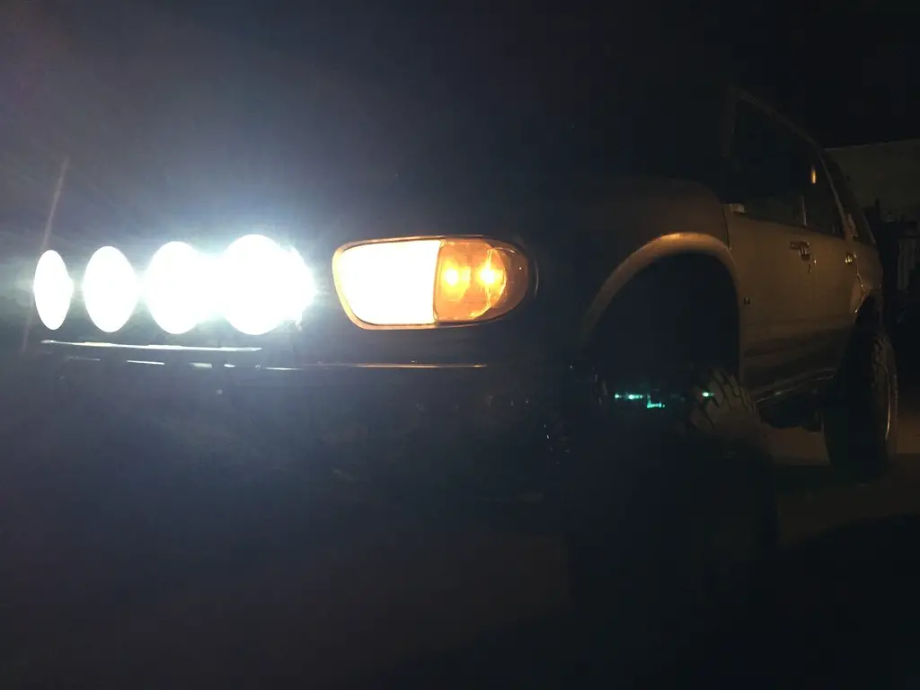

Updating my light setup, from 2 Kragen HIDs to 4 Hella 4000s which will get converted to HID. Whipped up this removable light bar for them tonight.

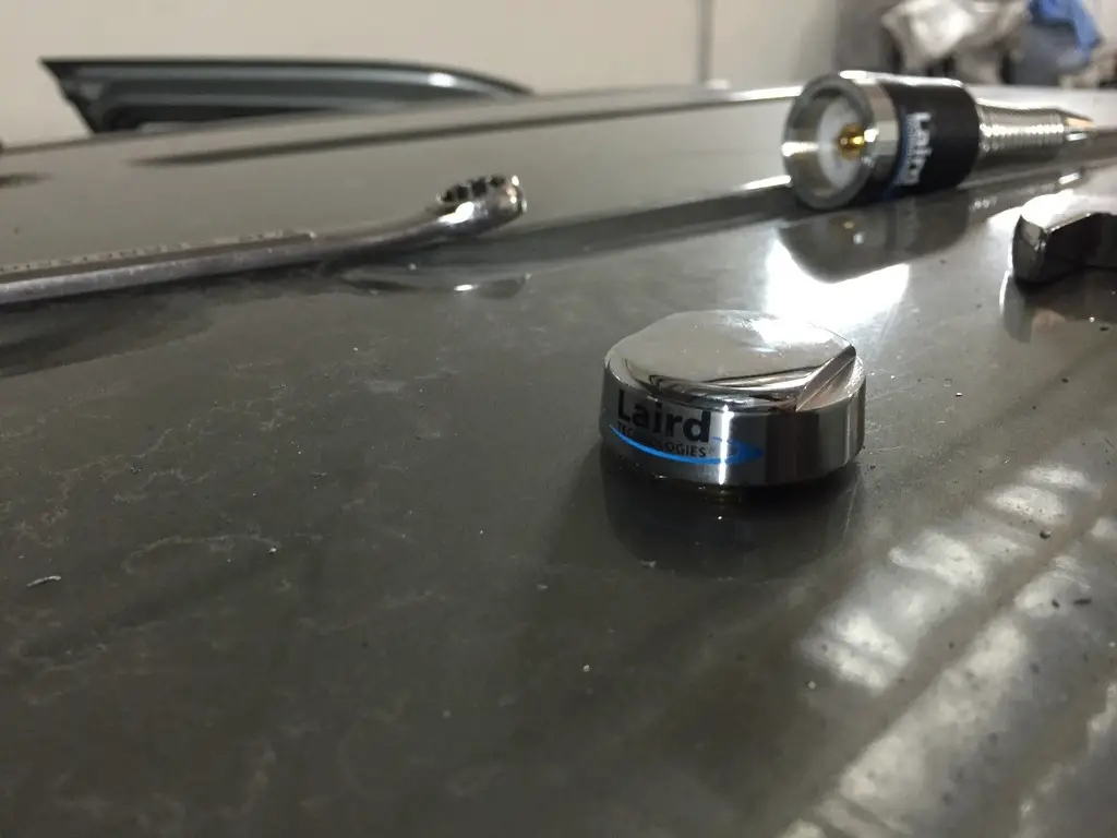

Made a little addition today and replaced my race radio antenna mag-mount with a permanent one in the roof. Got this blingy cap for the majority of time when the antenna isn't up.

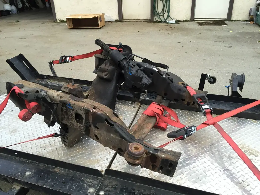

Some people who have been paying attention may have figured it out, but in the next 7-8 months I hope to have D35/D44 hybrid TTB under the front of this thing. My friend and I robbed a junkyard Explorer of the front frame rails and crossmember yesterday. Need to figure out whether I want to graft this crossmember onto my frame, or just use it as a jig to build a custom one.

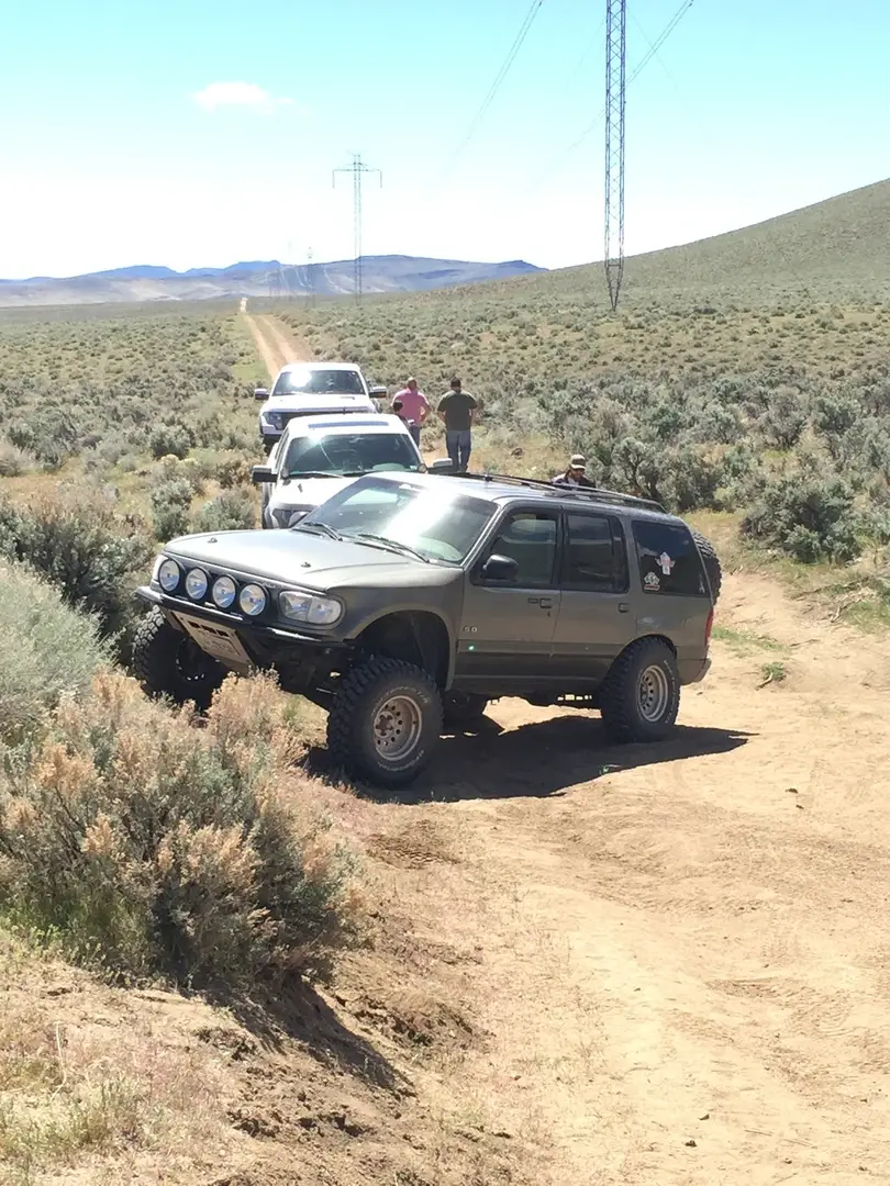

Went on one last trip this weekend with my current front end. From the city of San Francisco to snow in Tahoe to the desert in Reno, we covered a lot of terrain. Unfortunately a vacuum leak resulted in no heater when we needed it the most, being stopped at a chain check through Donner Pass for 3 hours. Snuck through the chain check and inched our way through a white-out down the hill safely, and had an otherwise problem free weekend. Wish I could say the same for some of the Raptors in our group.

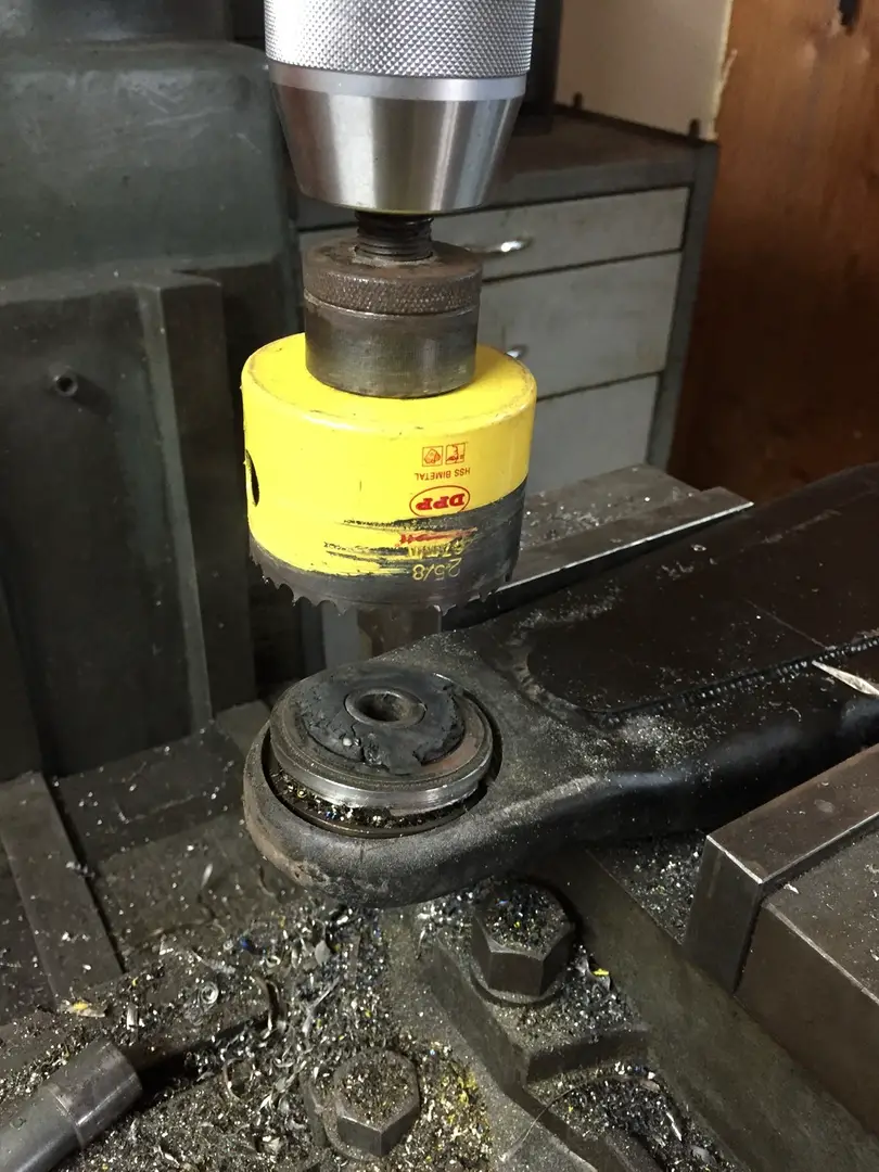

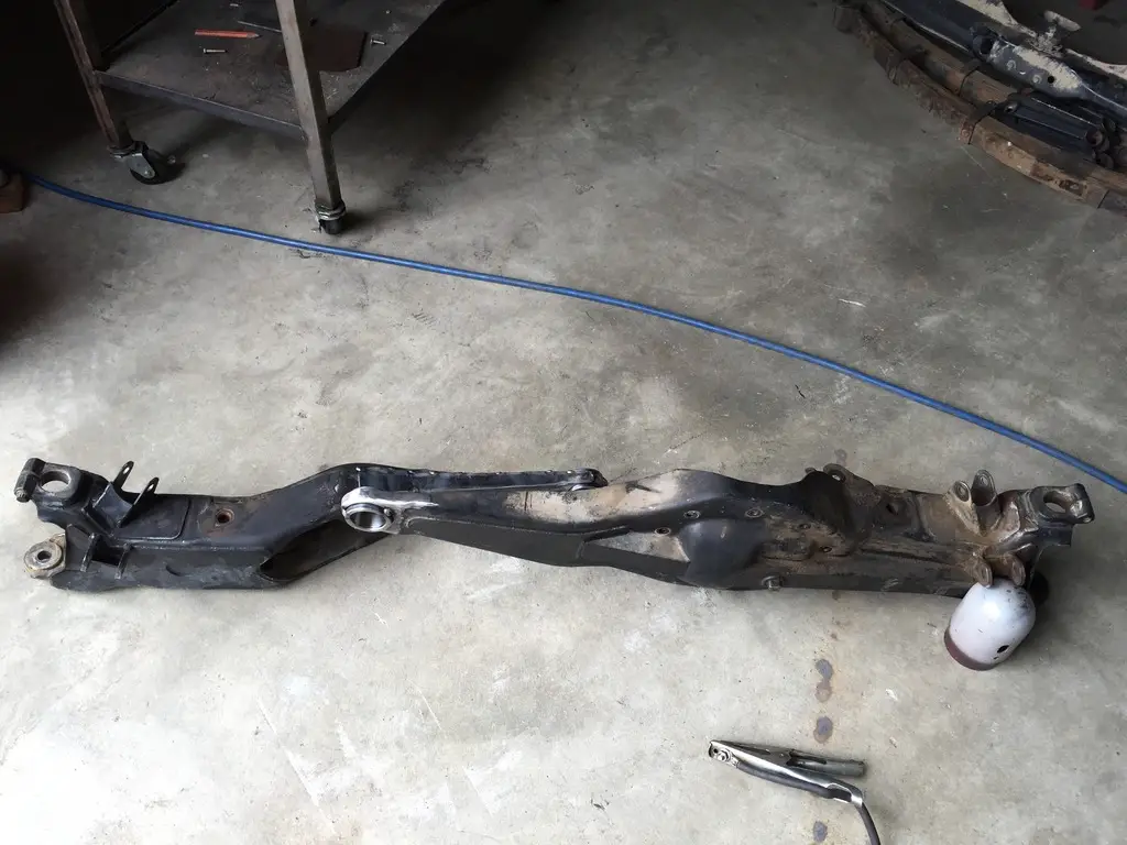

Got some work done on the beams today. Used my friend's mill to drill out the stock bushing pivots and tacked in the uniball cups.

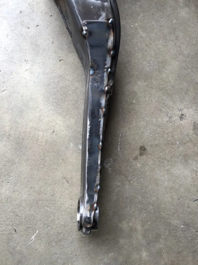

The beams had been repaired a couple of times by the previous owner when a couple of cracks formed in the top of the passenger beam, so I ground down the welds and then made an overlay plate on top to add a little more strength.

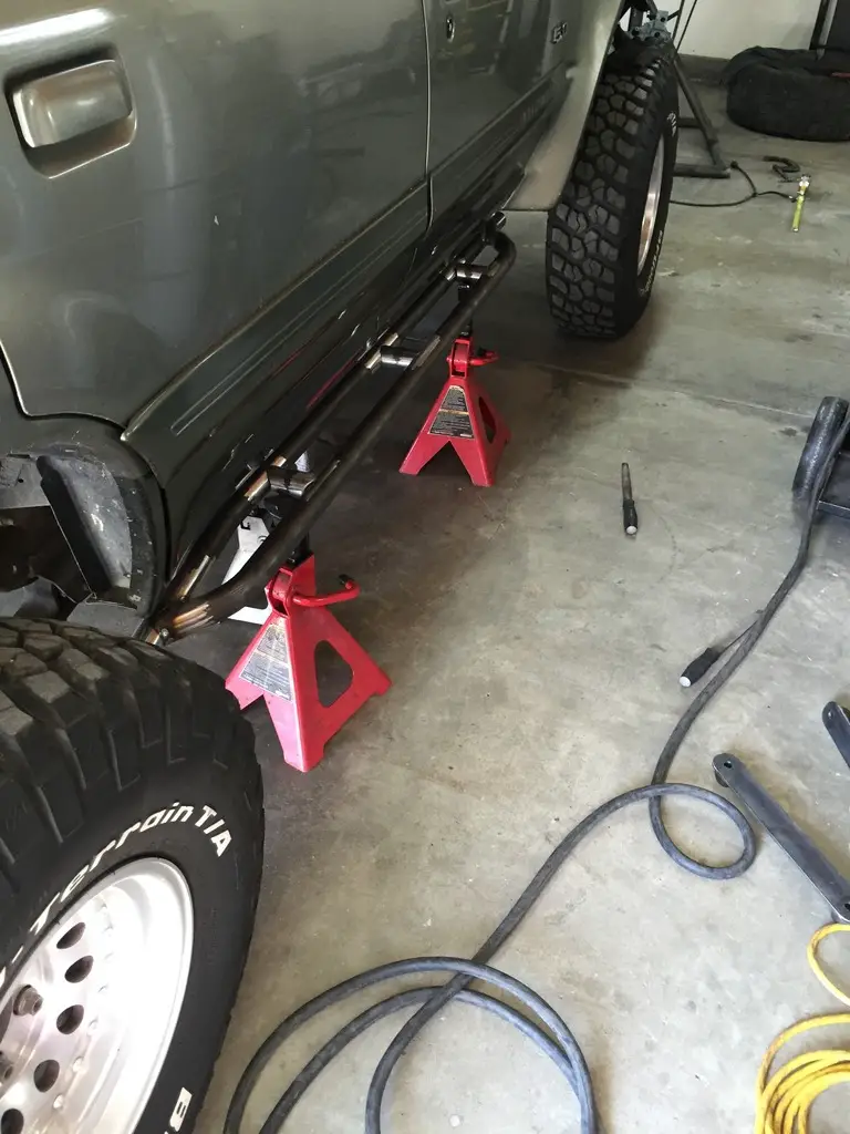

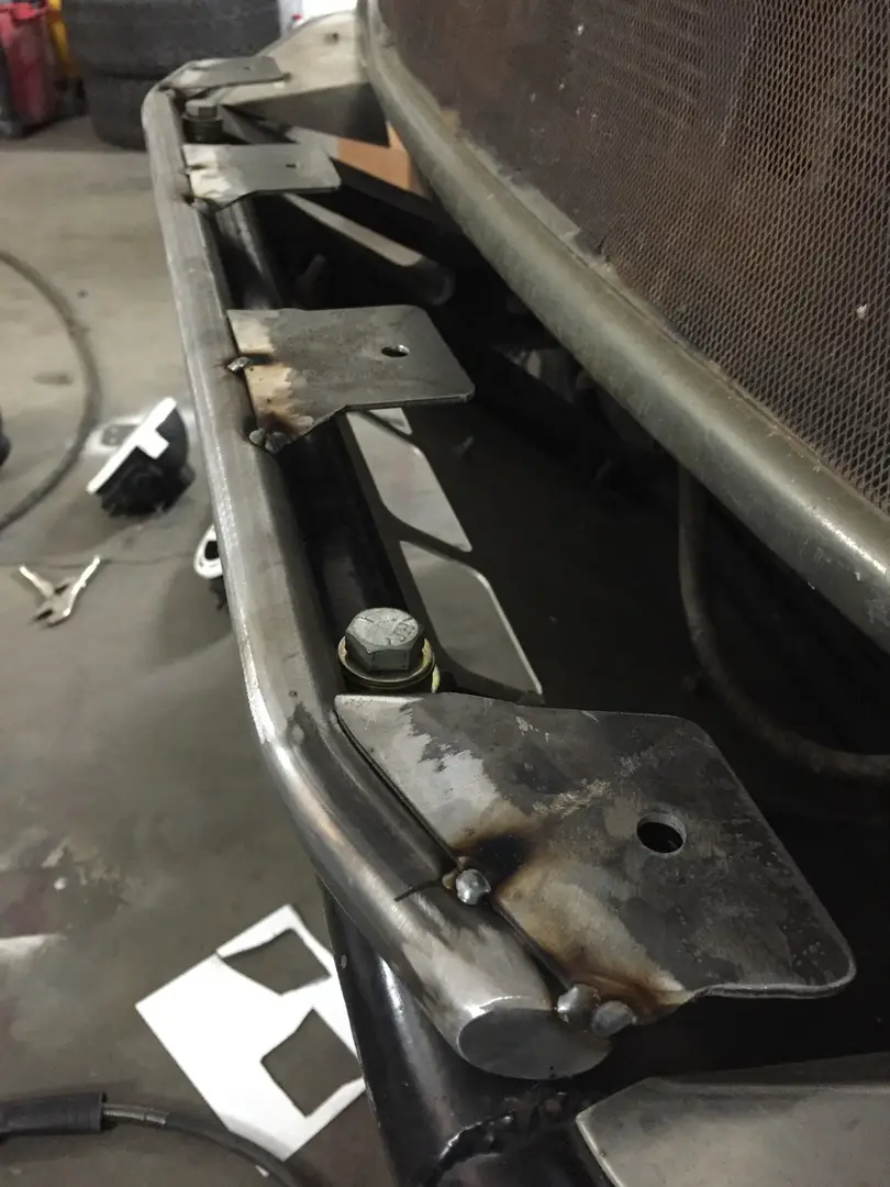

Started on rock sliders today and I'm really happy with how they're coming out. 1.75" x .120" DOM tubing, and I'm using the frame plate kit from Chassis Unlimited that will have 4 frame attachments. I will be plating in the top with a dimple died sheet, and the ends still need to be trimmed down and capped too.
