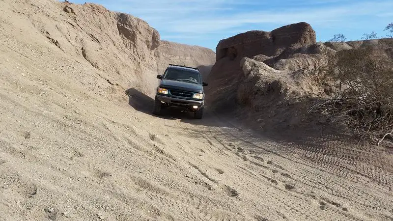

I didn't get many pictures since I was using my phone as GPS since I ended up leading on all the runs... Now that I think about it, maybe that's why there was so much carnage? But, we did get a 2wd open rear vehicle though a canyon/ditch with lots of flex...

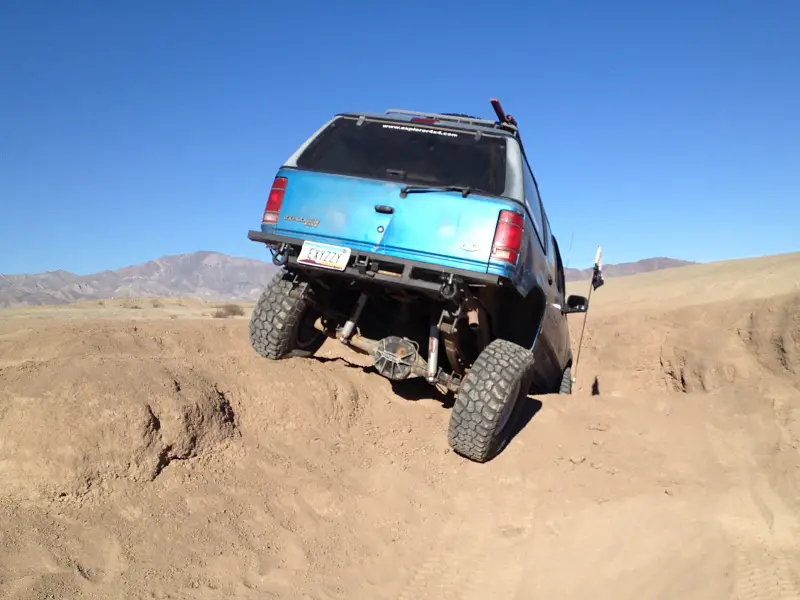

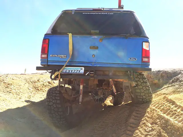

Here are the poser pics I grabbed when I had the X flexed up all the way... I haven't been able to find a place local to flex it this far.. I can now see where some things are hitting but other things are working as I want..

I'm not sure how long these stock spring are going to last if I keep doing this, but they sure flex...

The spring bottoms out, right when the shock does... and more importantly, the Diff stops right before hitting the frame..

Can see the axle shaft is hitting the Beam window in what looks like both compression and extension. Also, I can't tell for sure but the steering stabilizer mount "might" be catching the beam.. I'll have to crawl under and look for more tell tale marks.. I also have to remember to install a new boot over my c-clip eliminator.

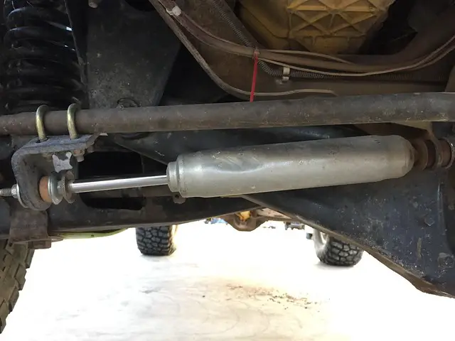

When I had it on the lift I also noticed my steering stabilizer looked a little off.
Untitled by maniak_az, on Flickr
The angle of the hit make it look like I actually got the stabilizer into the tie rod... I don't remember seeing that, but it's possible.. I may pull the stabilizer off as I put it on when I had potato chip shaped rims.
